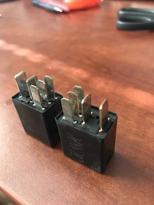

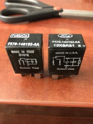

Didn't realise the post was from you Don. Kc, the first year for the Fuel pump driver module was on the 2005 model with the 5.4. At least on the Expeditions, the F150 pickups might have had it in 2004. They had the 3 valve motor a year early, and the 3.5 engine 3 years earlier than the Expy. He had the last year 4.6 motor. On my 2000, I blew the fuel pump relay about a week back. Since replacing it, it started, but sometimes it doesn't start. My thinking, and correct me if I'm wrong, the pump is drawing too much current, and that's why it blew the relay, and intermittent won't start. I wait 10 seconds or so, I'm sure that duration will get longer, then fires. I think I'll order the motorcraft $290.00 ouch pump. I hate to take a chance on the cheaper ones. Anyone had good luck with Bosch, or Delphi, or any in the $100.00 to $150.00 range. My original went 18 years. Kind hard to argue with that Number.
