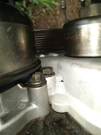

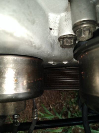

Hello all, I had a basic question about reinstalling a crankshaft pulley on my 2001 Ford expedition XLT 4.6. I went to install a crankshaft pulley after this timing job and at a certain point I could not go any further as the torque for the install tool got tougher and tougher.
I've attached a couple of photos so you can see how big the gap is between the timing cover and the crank pulley. It's about a quarter inch. It looks like I'm lined up with the other pulleys but just want to make sure that this is okay before I put it back together and run the risk of the accessory belt flying off. Thank you.

I haven't done that yet. And thanks for the input, I just wasn't sure if I needed to be at a specific distance from the timing cover. The other pulleys are a little closer to the timing cover, about 1/8 of an inch. The crank is a bit further back about a quarter inch but it still looks like it lines up okay.

That looks about right. Did you torque the crankshaft bolt down per specs ? ( New Bolt Required for torque to yield application ).
Ford 4.6/5.4 Crankshaft Pulley Bolt on Amazon
After torqueing the bolt in the pulley sat further in it's original position. Been a while since I've done this, I forget that tightening the bolt down does the rest of the work for you.
