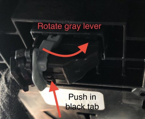

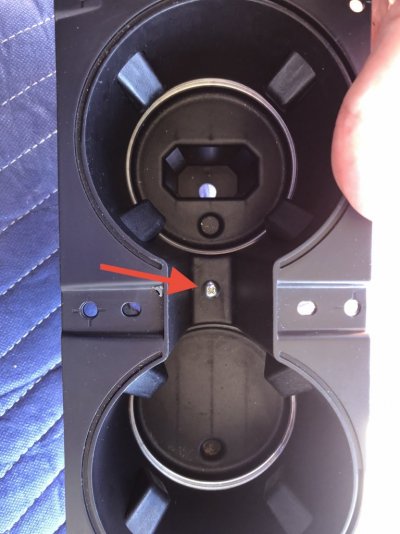

This is what the cover looks like from the top - I believe it's functionally the same for all the trim levels (i.e. you remove it the same way).Dang, wish you had some pics or videos. When you say pull up on the center console, the entire unit or the plastic that surrounds the cup holder (with the gear selector, etc on it)? Seems like some of us could really ***** some stuff up just pulling up on parts. There no way the entire assembly is just clamps, since I've already removed screws in the console to do the storage compartment work.
