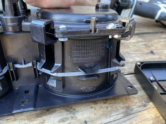

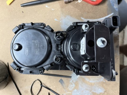

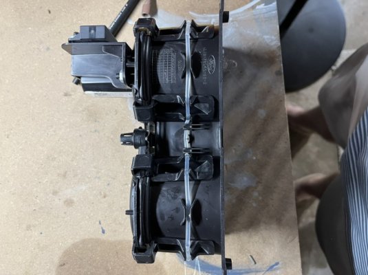

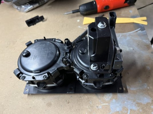

5C1FEA58-6118-4AD2-9A26-8A68C51EA3D2.jpeg73F74D2C-D1E8-4571-8887-4BA3D990B052.jpegBE692366-C5C0-4C85-AE1A-9D74C20B77E7.jpeg25280B87-C170-47BF-98D0-321FFB62932F.jpegI did this repair today. The YouTube video below help me to get the center console trim piece off. I had the same issue as poster above with the disconnecting the gear selector, so I unscrewed the four bolts that hold the shifter assembly to the piece, then I was able to remove the trim piece and then unscrew the cup holder frame from the trim piece. Having the trim piece off is definitely the easiest way to put everything back together and I was also able to do the zip ties to connect the bottom/flapper piece to the cup holder “frame”.
Some pics…

Just fixed mine as well. I never ended up unplugging the shift selector and 2wd-4wd selector. I just unscrewed the 6 torx-head screws to pull the cup holder out similar to MondayTX (thanks for the tip).
We drilled new holes over the existing plastic welds and bolted the the flanges together with a little thread-glue to help it hold. The solution is better than the original design and will last forever. Thanks to my father in law for the idea
