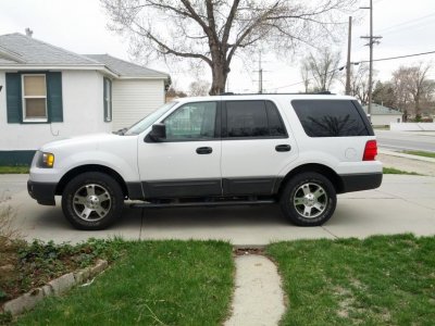

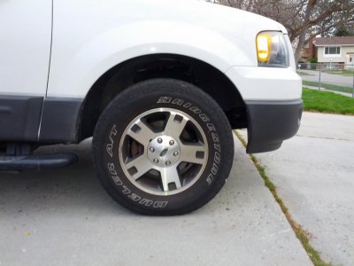

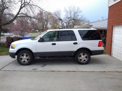

I just put the Rancho QuickLifts on my 2004.
1 will be way softer than stock. I'm finding that for a good stable, but not harsh ride I like about 6 or 7 all the way around. I usually keep the back 1 step less than the front.
I went with the Rancho's because for two reasons.
1. Height: My front raised about 1.5" and the back 1.25"
2. Dampening change: Initially, I wanted this to be able to stiffen it up like a truck when I'm towing, but being able to adjust it for normal day use is very cool. I guess the electronic gizmo you can buy to adjust it on the fly, has issues, so I wouldn't waste the money on it.
So far, I really like them. I bought them off of Amazon for $187. I can give you part numbers if you want them.
Good luck!

I doubt you will have a problem with the alignment, mine didn't change much. What you may have a problem with (which is my current situation) is finding a decent alignment shop that will actually put the vehicle in the preferred specs as opposed to what the $!&# computer says. I've now been to two shops and they both said they would fix it, and neither did. I've got a negative camber that I believe is too high, but apparently, I don't know what I'm talking about. :| I hate tire shops, and actually changed out the springs/shocks on my own. I may be slightly sick, but I thought it was fun. :)

I forgot to mention, but according to Rancho, your supsension won't be really affected until you go 2" or higher. The QuickLift on your Expedition should only raise the front 1.5" and the back 1.25", so you should be good. :)
The quickest shipping I found (and cheapest shipping) was from Amazon. $187.00 each, and they were loaded, which means they came with the springs (and you don't have to mess with the blasted spring compressor.) I ordered the back first, changed them out, then ordered the front. I should have done it the other way around, because it handled weird for a week. ;)
