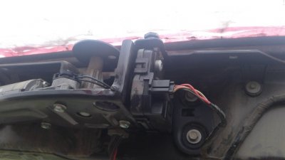

So I posted a couple weeks ago on my light being on, i replaced the driver's side door jamb switch light is still on. Now should i do take every other door apart including lift glass and fifth door and try to jump them to see which one it is or is there a easier solution.

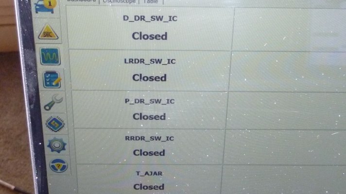

Do you have a laptop ? Do you have ForScan ? ( It's free .... Forscan.org ) . It's easy. In ForScan go to the dashboard and call up the I.C. module. Click on the door jamb switch PIDs you want to look at ( all of them...). Hit the run arrow in the lower left corner and have someone open each door while you watch ForScan and it's switch response. Pretty simple actually.

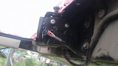

I just left my car turned off. Waited for the battery save to kill the dome lights and then opened each door until I found a door that didn't turn on the lights. Happened to be the last door, passenger side rear. I had sprayed the hell out of all the latches already with no luck.
Took the door panel off and found the switch going to the latch came apart in pieces. I think there was a spring and and a small metal ball. I just spliced the wires together and called it a day.
