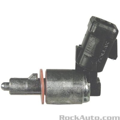

The door jamb switch is attached to the door latch and hangs on the bottom of the latch. Over the years a bunch of junk gets down in the switch mechanism and jambs it up. Amsoil PowerFoam is good for washing it out, but most people don't have that, so they try WD40. In the end you end up replacing the door jamb switch anyway.
Ford Expy Door Jamb Switches at Rock Auto

Thanks. Maybe spraying a little lubricant in there will solve the problem of it automatically locking the child door opening mechanism. I'm sure it gets a little embarrassing having to let my 16 year old out of the car.
Edit: I'm guessing it's in the door itself under the latch or I've just went blind. I tried some silicon as the wd is the other car's trunk and wife isn't home from work yet. Didn't do anything.
