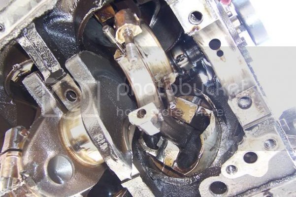

Standby for a rod to exit the pan or block. I wouldn't drive too much longer. Depending on how long before I yank this motor (should be in the next 2 weeks) to install my new one I will forgo the nitrous test :)( ) and sell you my perfectly working motor for cheap. I wouldn't recommend dropping the pan and trying to change bearings. It would need machining etc etc. This is what a rod knock that you keep driving on does. These parts are out of the 86 mustang in my sig. All stock with too much timing, rod knock, and a 250 shot

Rod knock is simply too much play in the rod bearing allowing it to slap around on the crank journal. Sorta like lifting your foot off the pedals of a bicycle and slamming them back down. This of course damages the bearing and journal as it progresses. It will keep running until you have catastrophic engine failure!! Such as the rod exiting the block..

Definitely is rod knock! It will need major repairs/ engine. Modular are great engines unless you run low on oil or lack of maintenance.

Rod knock. Heavier weight oil will do nothing but help silence a big problem. The problem is still going to be there. Not many cars run forever with a rod knock. Many different things could have caused this knock. The way the truck is driven, bad electrical, detonation, etc etc.
