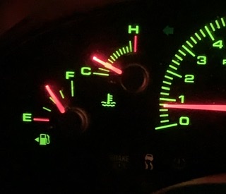

We just bought our 04 expedition (4.6L) 6 months or so ago. Today’s the first Cold day I’ve driven it.
Usually the temp gauge is a little higher than this? The picture was taken after 15 or so minutes warming up to defrost the windows and a 15 mile drive to work.
I haven’t checked to coolant level yet any other suggestions or is this normal for colder months?

Low coolant should result in a warmer than normal reading. It does on my truck. I'd check the thermostat. I had one hang up on my 82 K5 Blazer and it would get kind of warm if you were working the engine, but pull up to a stop light, or coast down a hill and you could see the temp. ga. drop off.

Yeah I’m betting it’s partially stuck open because it is blowing a little warm. Just didn’t know if this was a common problem with the 4.6 motor.

My '04 had the exact same condition when I purchased it earlier this year, and it was a bad thermostat. Mine is the 5.4L, but the thermostat is the same between engines. It's a cheap and easy fix, not much to worry about.
