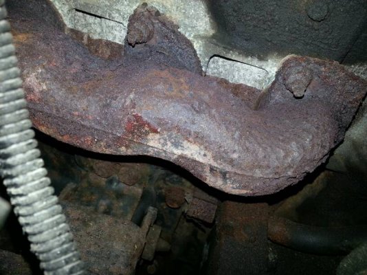

I was wondering if what's showing in the pic is any area of concern.
I currently am in the start process of tracking down this machine gun noise type exhaust leak..
Thanks in advance!

Keep looking and you may find a stud thats completely broken off due to the rust but generally it makes a "ticking" sound if the exhaust manifold leaks.
If there is an ignition miss associated with the noise you may have ejected a spark plug.
A deeper exhaust note or what I might consider a machine gun sound may be further down the exhaust. Maybe at the collector or egr plumbing.

I have had problems with the studs at the end of the manifolds that hold the catalytic converters in place breaking off. I have had none of the manifold studs themselves break off yet, but I replaced the drivers side set of those cat studs (fixed the problem through last summer) and now I need to do the passenger side studs this spring. Hope that helps.

If all 8 of your studs on either side look like that then I don't think that is where your problem lies. Like DJ said, look for a small hole.

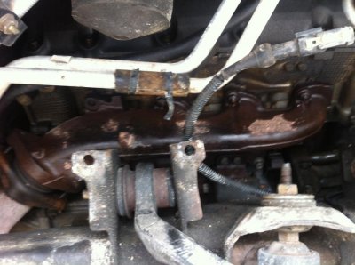

I had a similar noise before replacing them. And two of my studs were broke on passenger side on the rear closest to the flange.
Pic below.
