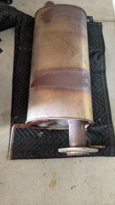

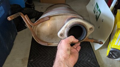

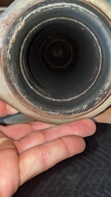

Hey Tunage, or anyone that has changed their muffler/exhaust, would it be possible to get some pics looking through the stock muffler? Front to back, and back to front, please.

You can about guarantee its got a million chambers and perforated cores and all that power robbing fun inside it. No other was to quiet them down well.

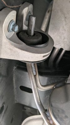

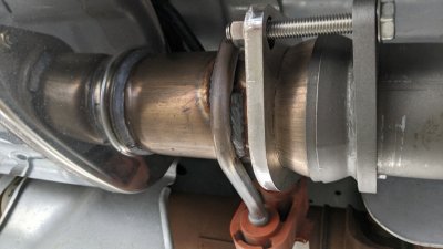

Yeah, I will take some tomorrow for you, I still have it lying around.
I have all of the dimensions of the MF muffler, they are nearly identical to the stock actually. Will also post that tomorrow.
I wish someone has experience with the resonance on the cgs. The exterior sound is great on it. I found a video of the 2018 expy with cgs from lge-cts group. Sounds great outside.
-------edit----------
Measurements:
Factory muffler is an offset/offset muffler. Roughly 26" long, 7.5" high, and 12.5" wide. The input is a solid 5.5" long, with a single non-jointed output. After looking through it, you can definitely tell it's a large, probably S shaped baffle design with no visible packing but you know it's between the set of perforated baffles.
MF muffler is also an offset/offset design with dimensions that are roughly 22" long, but 6" high, by 12" wide.
Images are added. The tricky thing with these is the shape/design of the hangers, they are difficult to line up and make without some really good metal tools.
