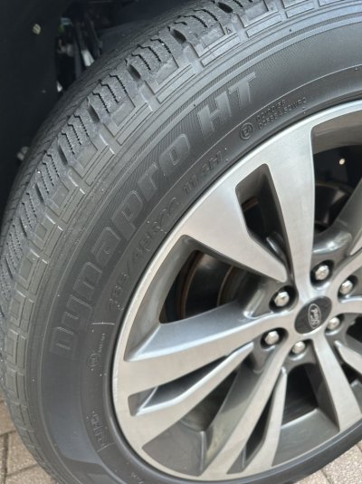

1. The ride is nice but not nearly as "smooth" as I thought it would be around town. You really fee every bump. Are the 18 inch rims smoother than the 22's? If so, I might downgrade later on.

22's may give you looks and sports like handling but 100% it will give you a rougher ride. Tires play a big roll in the comfort of the car.

Don't swap out the 22s. It will lose it's look, and you won't notice any difference. Check your air pressure on your tires.
You may want to consider resetting your TCM since you purchased a used vehicle. All the previous driver's habits are stored, and several things were adjusted and saved. So, you are driving on the learned habits of the previous owner. I always feel the dealerships should do this with all vehicles equipped with this feature. My Platinum was shifting weird, a little sluggish off the line, felt like a boat going down the road and more. I reset my system and over a period of about 2000 miles I noticed a huge difference. I'm shifting normal, peppier off the line, smooth like riding on air, better gas mileage, (just got 27+mpg on the highway, on a 1200-mile trip).

Based on what I’ve read here and other places, switching to 18’s make a major difference. Have you experienced otherwise?
Has to be what's stored. Mine is too smooth, almost floats. I do have the premium tow package, not sure if it makes a difference.
Don't believe everything you read. 18's, if the tire height is the same as the 22s, will give you a looser ride because of more sidewall.
My Excursion had 304/45 R22s on it and it was a bumpy ride. My 285/45 R22 Michelin Defenders give me a great ride on my Platinum.
What tires are on your Max Plat?

The vehicle stores a lot of information than can affect the vehicle's performance, handling and other info.
But thinking of our issue, you may have tires that are a different rating than spec'd for the vehicle.
That's why I asked what tires were on your Max Plat.
