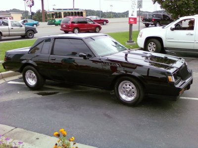

Never let dealer wash or send one out for detail.
Monkeys do it and it will be swirled to all get out.
Ultimate Cutter is my favorite for harsh swirls but any polishing compound will work.
A black waffle pad works for me.
Then I go over by hand with 1-2 coats of Zymol and it looks like this.
This is approx 9-10 inch black waffle pad on non DA polisher with the Ultimate Cutter to correct swirls and some dust puck marks and then hand terry cloth applicator of Zymol.
And NEVER take a car with good paint through ANY car wash.
You may spray a wishy wash one by hand but don't use the brush.
Factory paint is harder than a repaint even a high dollar show job(even non laquer) but still keep good paint away form car washes.
Wash by hand with 2 bucket method but ideally never let it get that dirty that you need any thing more that quick detail spray and microfiber wipe off.
