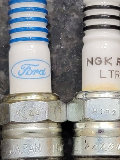

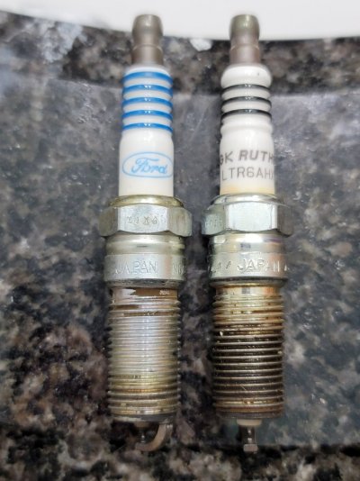

I love it when people pull random images off the internet. If it isn't random and you are using or have used the plug on the right in your 3.5 Ecoboost, you are using the wrong one.
LTR7BHX is the part number from NGK most people that know these motors are recommending. It is one heat range cooler, and comes gapped at .031. If you want the same heat range as stock, use LTR6BHX also gapped at .031. If you are tuned you should gap at .028, I even do .028 when stock in the Ecoboosts that are factory gapped at .031. You will notice a smoother idle.
Just because a plug is made by the same manufacturer does not mean it is the same quality. OEM Ford plugs have been proven not to last even close to their recommended 100K interval. If you are towing or doing a lot of city driving you will notice a drop in MPG around 30K. Changing the plugs will gain most of it back, and if you go to better plugs like the part numbers mentioned above, you might even see an improvement. Even with the NGK Ruthenium plugs I would not recommend a 100K interval. EcoBoosts are hard on plugs, as most Turbo motors are because of added cylinder pressure and heat.

NGK makes the Motorcraft spark plugs. As for the air filter the vehicle was designed for that air filter or vice versa. Ford will blame the aftermarket air filter if there are issues. In terms of warranty you are better of using the parts Ford tells you to use especially the oil filter If anything goes wrong they will look for aftermarket parts to blame and might give you a problem warranty wise.
Here is a Motorcraft plug and an NGK.

OK, so you used a better plug in the Duratec 3.7? The Great Uncle to the 3.5 Ecoboost we are also talking about, yet with higher pressure and heat, cause well Turbo charged. Yet you aren't willing to use the better plug in a Motor where it would benefit even more? Yet another example your logic is flawed.
Even looking at your picture where you are saying the plugs are basically the same because they are made by NGK, yet there ARE differences. The biggest visible difference is the size of the insulator around the center electrode. There is a big difference there. OEM plugs made by a manufacturer for an OEM spec are not the same as aftermarket.
