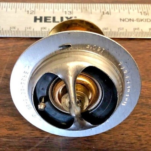

Back to the thermostat discussion… LOL. I have not seen this issue, but after research I decided to put in the new style thermostat. Mostly because I do tow and I don’t want my temperature to get to 240+ degrees. I ordered the RT-1252 thermostat and went to install it today. I noticed there was no Fahrenheit temperature stamped on the thermostat, just 90.6 C. I did the conversion, and that is 195°, not 190°. It should be 88° C. I search the Internet for half an hour for every picture I could find of this thermostat, and every one I found says 90.6° C. I didn’t only want the new design, I wanted the slight temperature drop as well. Thoughts?

Uh… Nope. Not seeing that. I did see this.
2018-2021..RT1252
2022-2023..RT 1250
I have a 2018, so I ordered the RT1252. I verified this on several web sites. Every single one that listed a temperature said RT1252 was 190°. Hence my confusion at the 90.6 C designation. Actual thermostats in the first picture. Note the extra spring coils in the new design, and also note that it does not come with the gasket. Test drive went well, but I do not have a display turned on for temperature (And hope I never see it, unless I turn it on someday). The gauge has always run in the middle and it may have been slightly lower, but hard to tell. Transmission temp may have been 2 to 4° lower, but time will tell

If the new thermostat was 190° the engine should run 5° cooler until maximum capacity on the cooling system was reached. This is what I was hoping for.

I did a little research this morning on the thermostat listed for the 2022+ models, the RT-1250. Consistent with the RT-1252, descriptions show a rating of 190°F, but the markings on the thermostat show 90.6°C, which is 195°F.
