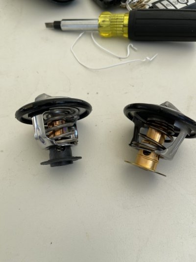

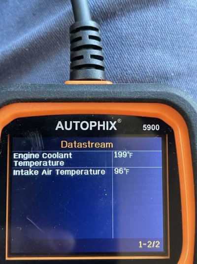

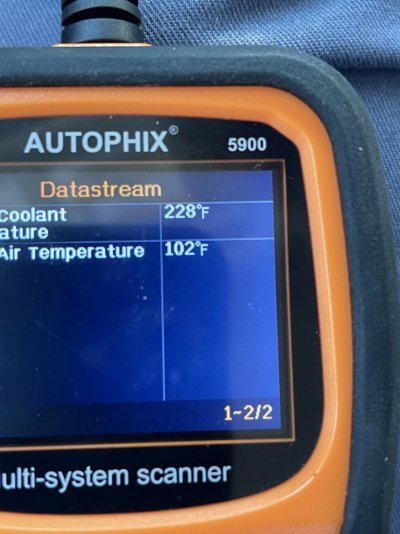

Got the thermostat swapped out this morning. Took a little longer than I expected, got hung up on the bolt on the drivers side. Would have been easier if I would have taken all the intake piping out of the way and the hoses off the thermostat housing, but I didn’t feel like taking all that apart. I did end up taking the top hose off the housing. Then I had an issue with the vacuum coolant filler I have. It wouldn’t seal off the little vent chamber on the coolant bottle. But once I figured that out I got it filled back up with no problems. Used a little more than a gallon and a half of coolant.
So before with the cruise control set at 60mph I was reading 228 degrees and now it’s at 199 and only gets to about 205 when letting off. At idle it’s at 195. A damn near 30 degree drop should make the whole truck much more efficient I would think. It’s nice not to hear the fans screaming all the time.

Nice, great data!
