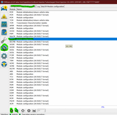

@wercsje1 here you go:
After connecting your Expy, click on the circuit icon middle left, than select "BdyCM Module configuration" & click the play icon at the bottom left.

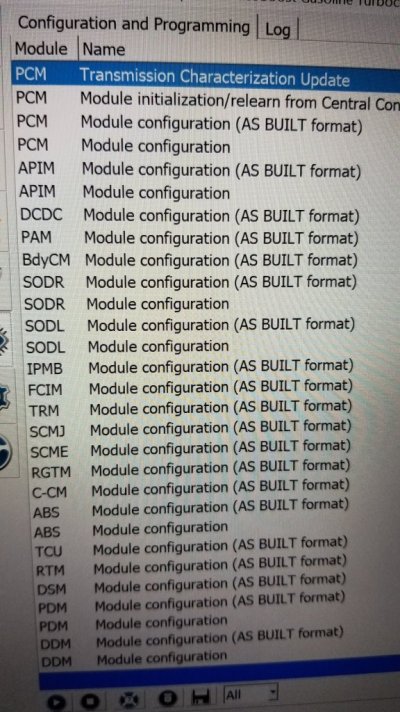

That can be part of my problem is I don't have a body cam module configuration I only have the as built format

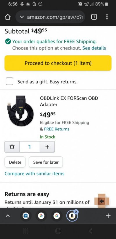

2021 Expedition Max XLT, using the most recent (last week) Forscan download, I have the trial/temp plan on Forscan and using the following cable on a windows Dell 1 yr old
