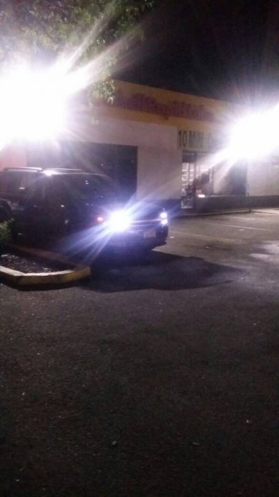

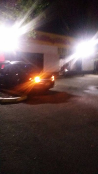

On the Flex I have led switchback turn signal bulbs so I set the parking as DRL
The 1st photo is how it looks when the parking lights is set as DRL 2nd is how it looks with turn signals as DRL. 88838d95a984ff75d31fdf1f34631a2f.jpg81d878a5751cc5644b85b13e38ec0718.jpg
