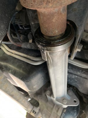

Just had mine replace 2 weeks ago for a slight seepage issue. About a 2" circle over a day or two. Shop put in a new seal. A few days later I noticed a 6" circle of fluid. Checked a sure enough, it was the new seal. They fixed it for free yesterday. The problem was the aftermarket seal they installed the 1st time. The seal was seated at an angle in the housing. They installed a genuine Ford seal this time. No leaks. Only a $20 seal so don't cheap out on an eBay special when it comes to fluid boundaries. Picture is the first leaking seal.

No it was installed correctly. This was the rubber not seated inside the seals metal housing correctly. It was cocked a little from the factory in China. I buy a lot of aftermarket myself, but this was so cheap from Ford.
