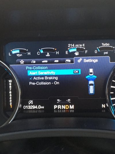

Before I take my 2019 Limited in for my first warranty service, I want to make sure that I don't complain that my front proximity sensors aren't working right if they're actually working like they do on other people's 2018-19 Expeditions. For starters, I measured the distance it takes to get the alert to sound. It is when the bumper is 2' away from a stationary object, and this object must be taller than a curb because they don't 'see' curbs. Also, if a person were to walk right in front of the vehicle with it in 'D,' nothing happens. My other issue is clear cut: even though it is set to 'on,' and the sensitivity set to 'normal,' the collision avoidance system does not function--no light, no alarm, no braking. Oddly the adaptive cruise does 'see' the vehicle ahead and maintains spacing. I'm starting to miss my old XLT pickup with manual everything.

Yes, and sensitivity was set to "normal" so I'll try to re-set it to "high" and see if that makes any difference. FWIW, every possible feature was activated when we took delivery...auto high beams and all.
