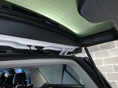

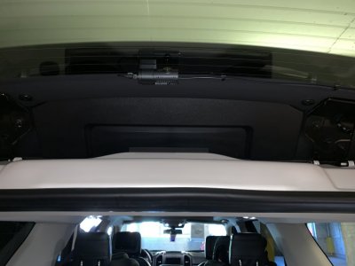

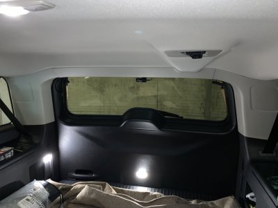

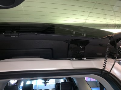

I have BlackVue DR-900s-2ch. Was concerned regarding the length of the rear camera cable, but it worked perfectly fine - like they designed it for Expedition Max :) I removed A,B,C,D pillar trims on the passenger side, as well as third row top seatbelt mount to drop the headliner and put the cable along side with other cable harnesses, so it won’t interfere with airbags in any case. At the rear I followed the heater cables and put camera cable inside the rubber sleeve so I can open the glass and tailgate easily. Will attach photos in the next post.

Here are some pics:

What did you anchor the cable to the glass with, was that something supplied with the camera?
This camera is on my short list... any complaints on it?
Adhesive cable clips came with dashcam. It’s been over a year since I installed it, so far so good.
