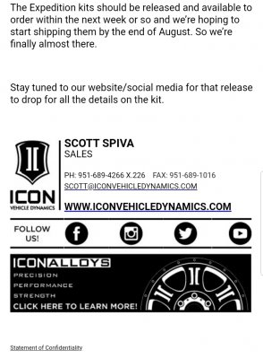

@16plati no clue. I asked about that but I didn't get any info other than what is in the response there. I even asked about the rear brake hoses since they go tight once you lift it...
I wouldnt be surprised if they only make the kits for the 18s+ And only the fronts. I relocated mine when I put the Readylift kit on my 16. They have plenty of bend when tires fully off ground now. I can’t bring myself to spend almost $2000 for adjustable coil overs. Next time I need tires I’m going F-150 5100s up front and expedition rears or 4600s and keep the rear spacer
