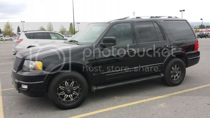

Last Thursday the wife and I bought an 06 Expedition Limited 4x4 for jockeying kiddos around. So far we love the vehicle, but it does have a few issues. Luckily I've found good fixes for most of them thanks to this forum which is why I registered. I was starting to get a bit nervous thinking I had bought my wife a hunk of junk but it seems like the things wrong with her car are all common issues which is a bit of a relief. Here's a photo of it I snapped right after we signed the papers:
