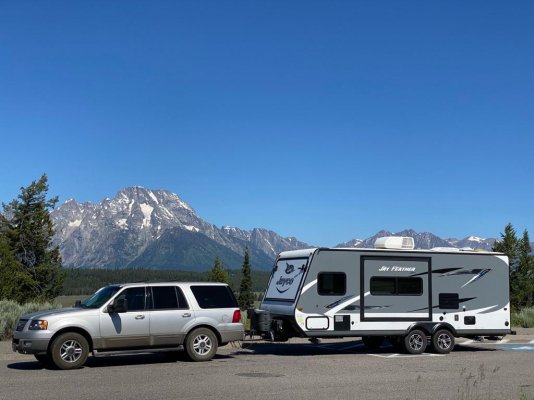

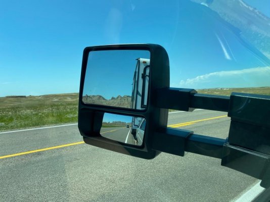

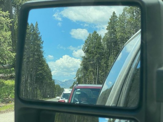

Here are some shots of those mirrors on a 2003 Ford Expedition XLT on a recent camping trip to Yellowstone.b62de9ea5bf0f0a81d2c8fbd44bd5aac.jpg
