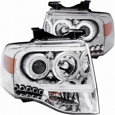

Well After a few months I decided I wanted to go to a bigger set of projectors. The little 2.5" projectors just looked tiny in that big headlight. This time I got a set of 3" Projectors, and thought I'd try Halo's & Demon Eyes.
Here you can see I painted the reflector bowls satin black, and I'm using chrome Iris shrouds for the 3" projectors.
I decided I wanted to try a street legal Demon Eye setup, so I picked up a set of amber LED strip lights and mounted them behind the lens.
They Look pretty good when lit up by themselves.
I also decided to run a set of Morimoto XBLED Halo's. Good lord these things are bright!!! So bright that they completely drown out the Amber demon eyes.
Here they are with nothing turned on. I kinda like how they turned out with the black reflector bowl. You really can't even see the chrome Iris shroud, all you see is the blackness, with the yellow ring.
Here they are with the Halo's & Demon eyes turned on. As you can see, the amber is almost completely washed out. The halo's are so bright, you can even see them in direct sunlight with no problems.

Thanks guys! The light output on these is a pretty close to the same as the MH1's I had. They seem to have a wider beam, and less foreground light, but the color and intensity in the middle is about the same. The reflector bowl is shaped and sized almost the same as the MH1. I did have one side with a fuzzy/yellow cutoff line. I had to bend up the cutoff shield a bit until I got the cleanest cutoff possible. It's weird because up close, like in my garage, the cutoff line is yellow, but over about 15 feet or so, the cutoff is blue.

The only aftermarket projector style light for our trucks that I know of, has 2 smaller projectors with small halo's. I just didn't like the look on my truck with those small projectors. One single large projector looked better in the huge housing IMO
