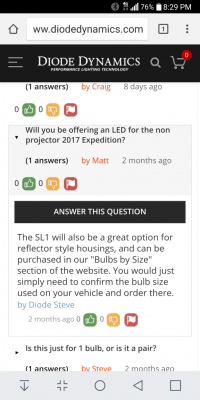

If you have a 2015-2017 the Diode dynamics SL1 is a direct drop in led(the only thats focused correctly) will also be far better than halogen

So are those SL1 plug & play?

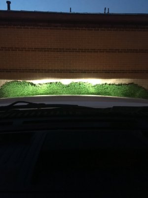

SL-1 install today. Roughly 20 minutes, easy as pie. Light looks great. Now to upgrade the H7 high beams to match the color!
Drove home last night. DRASTIC DIFFERENCE. Highly recommend!
