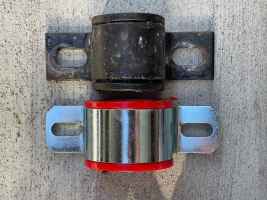

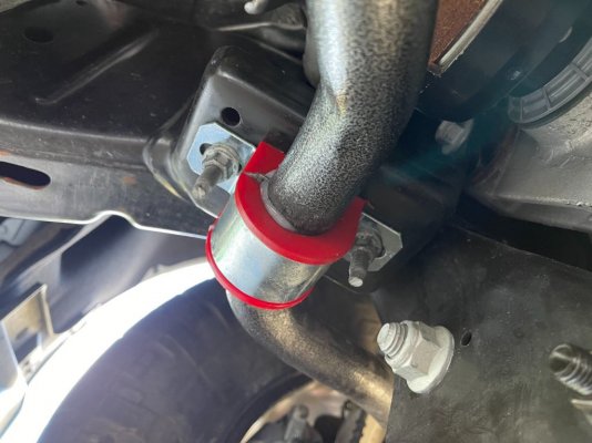

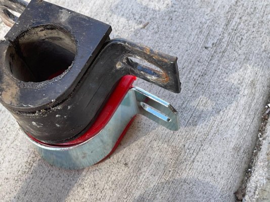

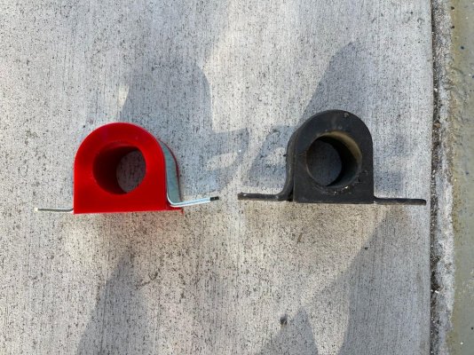

It didn't take long for a clunking noise to start after the front OEM bar was replaced with the Hellwig unit. Got worse as time went by.
Ordered Prothane part no. 191505 from suspension.com and replaced them today. Didn't hear any clunking with a short test drive.
The Prothane bushings are slightly larger; included metal brackets are thinner. They are also a better fit because the bracket holes are smaller.

The bushings are split so just have to pull each open to slip around the bar. I used a heat gun on low to warm them up so they would spread easier. Another way is to make them more flexible is to warm them in hot water.
Went for a longer drive and noticed an improvement over the Hellwig units. I think the Hellwig bushings are softer. That along with the play that developed that caused the clunking made the front end more sloppy.

Judging by the OPs pictures they are same thickness. But why would you want to reuse the stock hardware? What’s the benefit? That’s like taking a shower and putting your dirty soiled used underwear back on. Just get new ones

The stock bar is slightly smaller in diameter than the Hellwig. I pulled the OEM bushing out to check first before getting the Prothane units. OEM brackets have a more precise fit since they the holes are not elongated and sized well. Hellwig bracket holes are elongated and larger so there isn’t as much contact with the nuts. The Prothane brackets have slimmer, elongated holes so figment is better than the Hellwig hardware.
