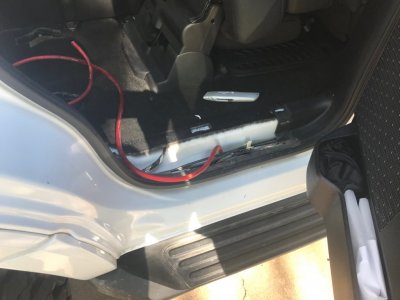

First I simply replaced all the speakers. With no Amp, there was not enough power to drive these speakers so it didn't sound great. Better than stock but not by much. It was obvious they were under-powered.
So the install began. I opted for a new challenge and decided to do this myself since the installers close to me were quoting $700 - $950 and the 2 places I tried both canceled my appointments in 1 week. Impatience made this become a weekend project for me.
The 4 Gauge Amp Kit was easy to install. I was able to run the battery cable from the engine bay, down the wheel well (Passenger/Battery side) and use wire covers and zip ties to secure it safely under the frame and up through a plug at the passenger rear door under the interior door molding. Below are some images.
My location options were limited for the LC7i and 2 amps since mt 3rd row seat is always down and very often the back seats are down for carrying bicycles and racing gear around the country and I didn't want them out in the open. What I found was, the 2 Amps fit perfect and had clearance under the center back seat and the LC7i and power distribution blocks went under the drivers side back seat keeping the components all close to each other and the wiring nice and clean.
Now it sounds way better.
