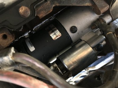

I just took off the solenoid and used a 1/4 ratchet with a 3" extension to break the top bolt. Then had to switch to a 2" extension.
Dropping the starter out was a nightmare. It only comes out one funky way.
Im about to start installing the new one, but , I doubt ill be putting the top bolt back in. Ive read some places that is commonly done.

Two funky ways, remove solenoid or use extensions.
I did have the wobble socket and extensions shown on youtube , but could not get it positioned as the guy showed.
I spent well over an hour trying numerous methods and extensions shown on the internet and I came to the conclusion a 2007 4x4 el limited has something off in the architecture from later years.
Though I could be wrong.
I consider solenoid removal as the only way to remove the starter.
