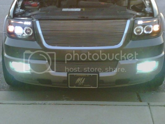

6000k HID fogs
heads/fogs HIDs 6000k

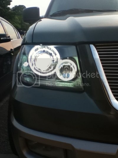

retrofitted with projector 6000k HIDs
