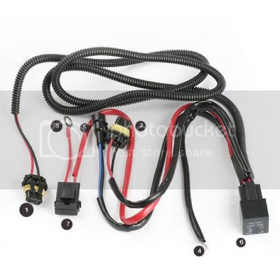

Does your relay kit look something like this:
1 and 2 in the pic go to your ballast.
3 & 4 are the positive on battery and ground.
5 is the "signal" input and hooks up to one of the OEM bulb connections (of the bulbs you are replacing, usually the closest to the battery)

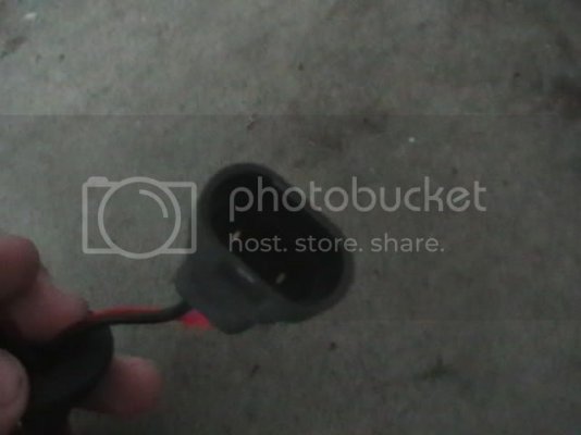

This is what 5 should look like on the inside.
See the 2 metal tabs in the connector?

ok...yes this is what i have...but No5 is loose wires with for the signal input with female connectors (different sizes) instead of the connector end you have...
14,565
893
Newport News, VA
so with the connector you have on the pic...that goes to the bulb inside the headlight, right?
That #5 plug would plug into the wires on the trucks wiring harness that normally plug into the headlight. That is what tells the relay to turn on and off.
