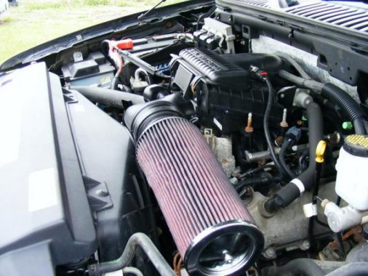

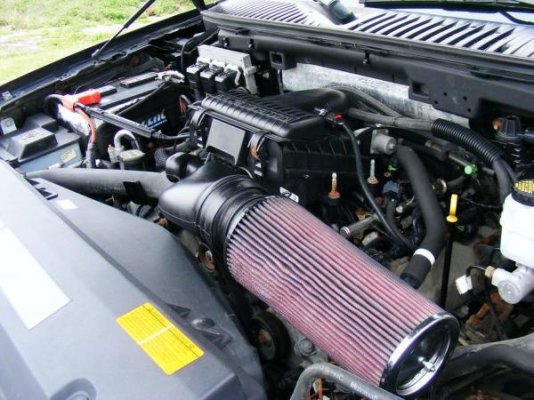

I just removed the stock air filter and silencer and replaced it with a K&N Air filter.
1. Removed the elbow & silencer box assembly (no tools required - the elbow side just pulls out - with a slight up/down movement. The silencer box pulls up - it's connected by 2 slots on rubber grommets - it also pulls straight off from the inside fender).
2. Separated the silencer box from the elbow which connects to the air filter box (that was a lot harder than I thought - but it just pulls right off - after twisting for a bit).
2a. Cleaned the inside of the elbow from dust/dirt.
3. I used a old air tube (from my 5.0 Mustang - which happened to fit both the K&N filter and stock elbow openings) to connect the K&N to the elbow.
4. Made sure it sealed properly.
5. Removed air filter and cleaned the inside of the filter case.
6. Reinstalled the elbow w/ the K&N attached to it.
Options I am considering:
1. Might use 1/2 of the original silencer (the front area) to provide cold air directly to the filter - this might be more effective in hot climates.
2. Might have to secure the front of the filter (it's free standing - only attached to the elbow, but another bracket on the front of the filter would make it stronger.
Here's how it looks.

Driving Experience... I didn't notice (or expect) much difference in drivability or performance, but I do notice a louder / deeper sound from the engine. Gas mileage has remained the same.

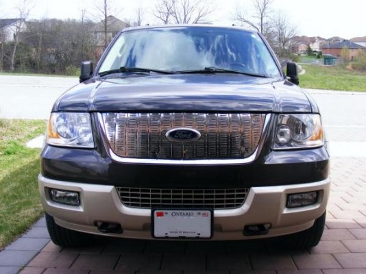

Thanks - your Expy looks amazing btw :) What do you mean my "cold fronts" ?
in for answer to this as well, because i have a similar set up
see the shinny stuff in the top grill....look at the bottom grill...unless the light is messing with the picture...those are cold fronts that are put in during the winter time to reduce the sub-zero air moving through the engine bay...was stationed in alaska and in north dakota and during the winter...you see trucks/suv's with the cold fronts in them...spring/summer/fall theyre out...
you are in canada...lol
IAExpy

I see what you're talking about, I thought he just had a chrome grille insert... i don't have that on mine, so no worries here
Here's a close up of what I have... it's just a grill insert cover... I am sure it will reduce flow a bit compared to stock, but as far as I know, it's not intended as a "cold front" - It has a lot of "holes" for airflow... We'll see this summer if the temp is high :)
I just bought it and it came like that...
Anybody use these types of cover in hot climates and had heat issues?
