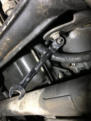

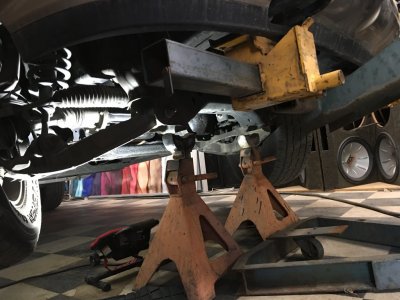

I have found it extremely hard to find step by step pictures on the internet on how to change your A/C compressor on a 2003 Ford Expedition 4x4 with the 5.4L V8 Triton Engine. I am going to start this project and document the pictures myself. For reference, this is not a fun job, the compressor needs to come out from below the vehicle. Therefor on a scale on 1 to 10 I will rate it:
Suck Factor = 7.5 / 10 (Meaning Irritating is a mild way of putting it)

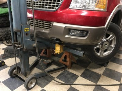

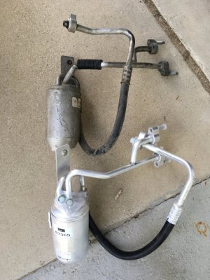

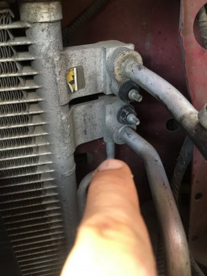

You will need reasonable aptitude, good tools, a way to recover freon, or take it somewhere that can, and a safe way of lifting the vehicle so you can access the compressor from the underside. In addition to the compressor you should replace the expansion valve, drier, oriface filters, and flush the lines for any contaminants that may have travelled downstream from your original damaged compressor.

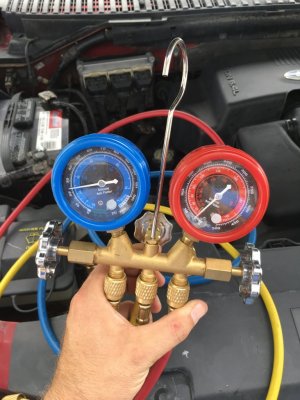

Make sure you put gauges on the system before trying to remove any components. If you have high pressures, you can have a shop with a recovery machine pull the freon before attempting to take things apart.

I'm not going to sugar coat this job at all. For an A/C compressor, it is completely ridiculous. It takes exceptional patience to squeeze your hands into unreasonably tight spaces with little space for movement of your tools. The serviceability of the A/C compressor on a 2003 5.4L V8 4X4 Expedition is unacceptable at best. I completed it.
For those who are still inclined to put yourself through this misery, read on.

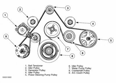

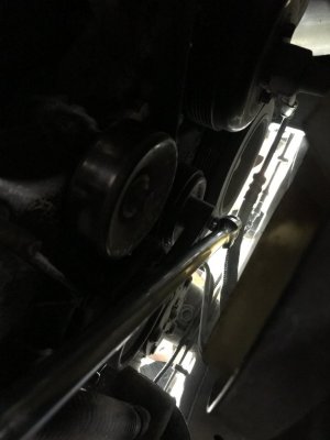

Before removing any of the bolts, remove the serpentine belt, see pics in next post.

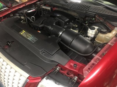

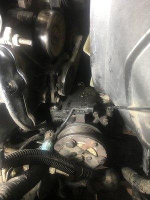

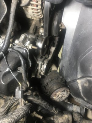

Please read all posts and view all pictures before starting this job as the pictures are not all in exact order. Some steps like removing the belt come first.

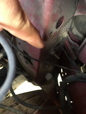

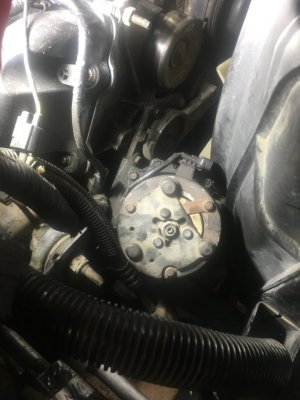

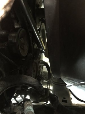

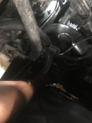

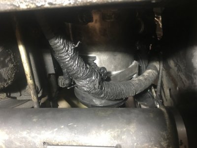

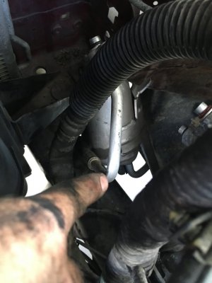

Use a 1/2" breaker bar inserted into the idler arm to push and release pressure on the belt so the belt can be removed from the compressor. One of the stages of the A/C compressor removal that most people don't discuss is how to get it out after it is unbolted. There simply is not enough room to pull it straight out. Your expedition will have to "give birth" to the compressor. I chronicled this in timeline shots. Pull your flexible lines forward away from the engine and hook over the frame rail. Rotate your fan blade and pull the compressor up between the frame rail and fan shroud. It will push on the shroud, but with some rotation and motivation you can bring it up and out.

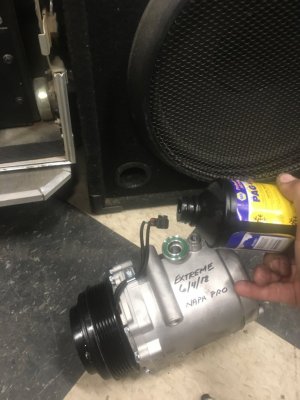

Please review all notes and pictures before starting this job, some pictures may be out of order.

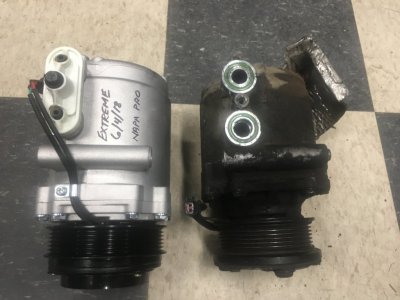

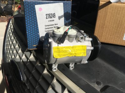

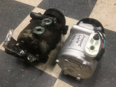

The 2003 Ford Expedition with 5.4L V8 4X4 with rear air calls for 14oz. of PAG 46 oil to be added to the compressor.

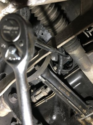

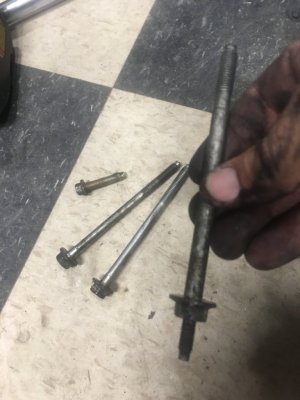

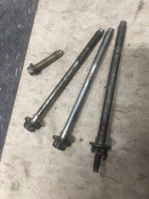

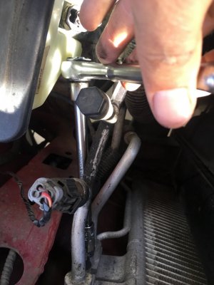

If there is shipping oil already in your new compressor, dump it before adding the PAG 46. The bolts for the compressor are long, temperamental, and east to strip. Take your time to remove slowly. If there is any corrosion, soak the bolts with penetrant oil overnight before starting their removal. The three larger 13mm bolts hold the compressor to the engine block, and the smaller 10mm bolt holds the hose manifold to the compressor inlet and outlet.

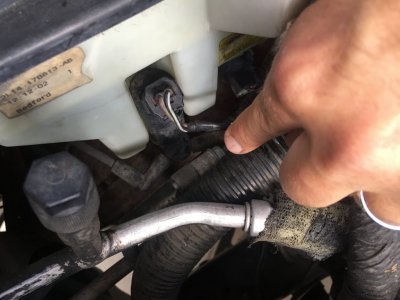

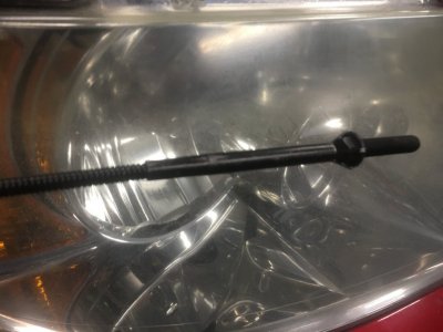

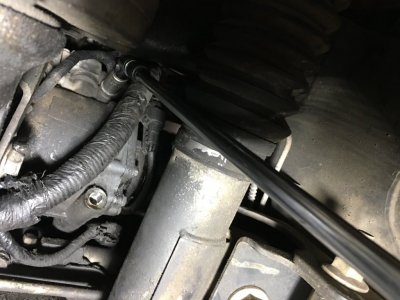

I used a flexible "Grabber" cable tool to place the 10mm manifold inlet bolt for the first few threads, secondly fed a 10mm open ended wrench to slowly set the next few threads until the bolt was seated. Once the bolt was seated, I finally had enough space to get the super long extension with a shorty swivel into place and finish tightening down.
Then was able to reinstall the belt, it is easier to take off of the alternator, install the belt onto the ac compressor than reinstall belt on the alternator. Finally I was able to install the battery and button up any loose connections.

Extreme: You noted that the compressor (vehicles with rear air) will need 14 oz. of Pag oil, is that for just the compressor or the whole system???
Hamfisted
Nov 20, 2012
2,894
1,796
Ft Lauderdale
Just the compressor.
Whole system PAG oil capacity is 54 oz .

Oil is complicated. 14 oz is dry system amount. If the system has not suffered a lot of oil loss then it needs what you can drain out of old compressor plus 2 oz to be safe. The new compressor will have 6 oz usually and that is dumped out and new oil based on old compressor dump + 2 oz is added into suction port of new one. If accumulator/drier is changed add 2 oz to it before installed. The oil scatters all over and does not sit in a sump in compressor. System spec is 14 oz but you have about a 20% +/- range and all is good. Too much and compressor will have risk of hydraulic lock after it is parked and oil settles and cooling will be less than 100%. Extra oil means less refrigerant room and it can be overcharged for this reason and not cool well. Too little and compressor will fail from inadequate lube. If you put 14oz in and there is no failure that would have lost A LOT of the oil then you could have 10 oz too much in it.
