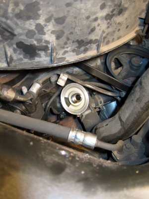

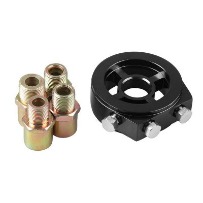

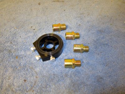

I tried to hook it up directly to the engine but couldn't find the right adapter. The only sandwich adapter that you will want is the one with all 1/8" NPT ports. Most of them come with oil cooler ports that you will have to block off and 1 NPT.
The sleeve in the stock mount stays in there and it has a 22mm x 1.5 thread. The sandwich sleeve takes a 26MM or 1" socket. The sender has a 1/8" NPT, most do.

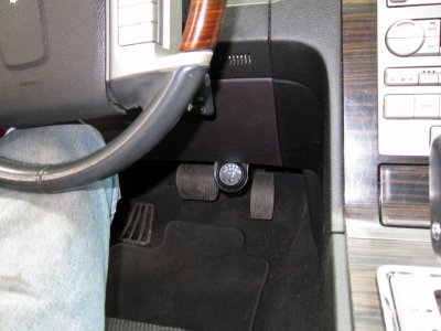

Trace around the bottom of the plastic dash cover at the bottom so you can locate the gauge mounting area. I used self tapping screws here.

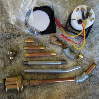

It works fine and there is plenty of leg room plus the original one still works and it is inconspicuous . I could only load 5 files here which jumbled up the whole thread but they are all in now. The one with a bunch of fittings was part of my first attempt.

All I have to do is glance down at it for a split second while driving (very visible) and it is important on these engines due do low oil pressures killing them. The stock gauge only comes on at 10 or 12 psi but shows about 60 PSI. It is only an idiot light type switch, not a real gauge. This gauge will mainly tell you if you need a new oil pump or if your engine is completely worn out...........very good to have. I am glad to see that my engine has 50 PSI hot and in gear idling. Some people have them inside the console, it's not something you have to monitor. Looking at it once a week is 100 times better than not having one.

So if I understand correctly, you aren't using all the pipe fittings in the last picture? Cuz if you are I'd be really concerned with the pipe cracking or breaking with the weight of the sender hanging on it....

I just threw that in (it said it's part of my first attempt). I was concerned about a pipe cracking (originally) but I was going to fabricate a bracket to hold the sender firmly. The sandwich is probably a better idea anyway plus the stock gauge still works with it.

ohhh geez that's a safety hazard
interference with safe operation of gas pedal & brake
and the wire add ... why i never want a used vehicle
thanks for the info though, nice effort
The gauge is nowhere near my leg, totally safe. Plus there is just a wire to the fuse box and one to the the sender. I would rather buy a used car with a real gauge, you could have 10 PSI and not know it! Also with a hardwired gauge you could get a cab full of oil.

It's not that hard, just make sure you get the sandwich with all 1/8" NPT ports or you will pay more and have to block of the oil cooler ports otherwise. I'm glad to see it shows 35 PSI with hot oil and in gear. Those without a real gauge could have 10 PSI and in need of a new oil pump.

China special but they are all basically the same, just make sure it has 2 oil sealing rings and the sleeve/filter bore is 22mm. I didn't take long but they lied about having a warehouse in the USA. If I wasn't so tight I would have gotten one locally.
