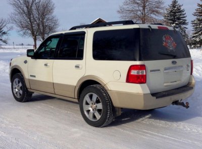

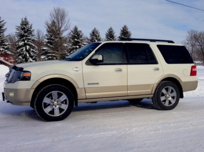

I wanted to level out the rake on my 08 KR. I ordered the 2" (1.175" thick aluminum) spacer kit from ebay (came from summit)
After the install it was plain to see that the new front height was too much in perspective to the rear.
Not listening to the "can't be done" crowd, I did one of the easiest suspension modifications I've ever done.
I've made adjustable ride height links that effectively fool the sensors into thinking the truck is too low. I'm currently running at 1 3/4-1 7/8" lift in back with no issues. Any more than 2" and a guy "could" add a thin spacer to the top of the air strut so it operates in it's factory designed position. At 2" lift the strut is only expanded out 1".

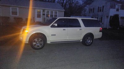

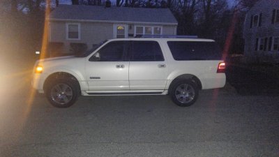

So I have a question. I installed a 2" level lift in the front 1.75 thick and ended up with about 3" of lift. You said your spacers were the same but mine is really high and not sure why I got so much more. Crappy pic but it's high enough to make my wheels/tires look tiny. I'll get some day shots tomorrow after work. Any thoughts?
gixer2000
Retrofit or Bust
Oct 13, 2015
1,467
644
Massachusetts
Just noticed your spacers are 1.175 so that's the difference. They claim this gives me 2" but it's way more and has to go. Do you have a link to the ones you ordered?
