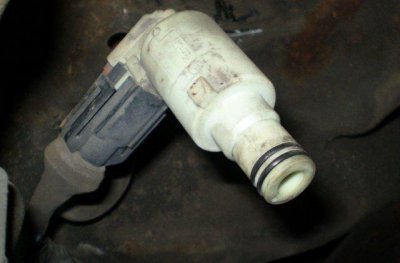

ok I looked up the manual, To take the solenoid out you had to turn it counter clockwise. So I assume you replaced it turning it all the way clockwise? Also returning the retainer clip and air hose clip. I would take out the solenoid and verify air is present. If not then first guess would be bad solenoid. Next would be hole in hose somewhere.

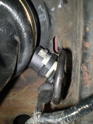

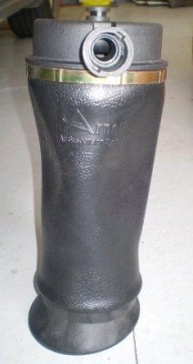

I would also ensure that the o-rings are intact and properly oiled. I also purchased the Arnott compressor/dryer and rear bags several years ago. I did have to call them on the compressor/dryer as the directions were a bit "unclear", however they were very fast to articulate back in "DIY" wrenching.
Hope you figure it out.
PanHandler.

So i went ahead and lifted the expy again and started inspecting everything, everything looked just like it should so i decided to check the wires carrying the power and low and behold it looked as if it were chopped off. i i bought some wire and re connected the ends, and it aired right up.
Thank you all for your help and input on this, it was all very appreciated.
