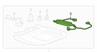

WTF is an "Intrusion Sensor"??? I must be getting old.
I looked it up and found this article about F-150's sensor.
https://www.f150forum.com/f118/2015-overhead-console-intrusion-sensor-retrofit-416887/
Just passing it along if anyone else is ignorant to these things and wants to know.
I'm going to make a very stupid guess here and speculate that the intrusion sensor somehow fail-safes the auto start if nobody is in the vehicle.

I had my 2018 Expedition serviced on Monday for smart locks not working on any doors and I had start / stop not working for few month. they diagnosed it as intrusion sensor failure and replaced the part (EB3Z-15K609-A) all door locks started to work normally and engine start / stop started to work as well. may be a coincidence.
$46 part (for those out of warranty)
https://parts.spford.com/oem-parts/ford-sensor-eb3z15k609a
