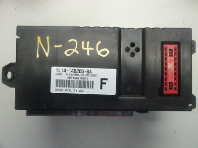

If memory serves me correctly on the 2000, the GEM is mounted on top of the interior fusebox. There is not really anything that you can service on the GEM itself, but I'm thinking there might be some obvious modifications made to the wiring harness in the area - look for cut/spliced cables.
I would not suggest taking any action, just look around and see what you might find. Attached is a picture of the typical GEM from that year/model.
