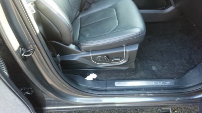

Anyone else developing water in the front passenger floor of their 4th Gen?
Backstory
I didn't notice the wet floor during the test drive, but on the way home my son said the floor was really wet. I brought it back to the dealership and they insisted it would be mitigated. They applied the fix mentioned in the technical bulletin regarding the AC drain. (Interesting side note: the technical bulletin says it's for Expeditions manufactured after Aug 2018, but my was manufactured before that.) It was really wet so I doubted that was the sole origin of the water. They claimed to also have done a leak test to make sure the sunroof wasn't leaking. It's been a week and the floor is dry, HOWEVER the carpet is still wet under the trim near the B-pillar.

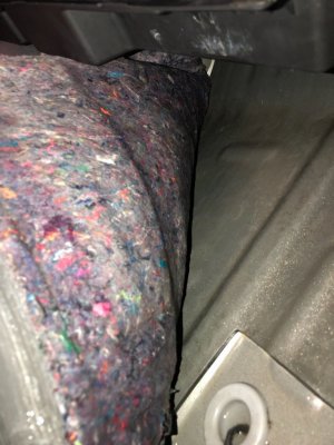

I've been jamming paper towels in a small gap (see attached) and it keeps getting saturated. I've gone through 10-15 towels and I have driven the car a good 10 hours, with the heat on. If this was residual water, shouldn't it be dry by now?
Should I bring it back to the dealer?

The carpet and any under pad should be replaced by the dealer under warranty - or removed and cleaned, with the floor boards cleaned and disinfected to prevent mold.
The dealer did a bad job.

I'd also be a little concerned about rust after this long, I realize much of the body is Aluminum but there are still plenty of non-aluminum parts in that vicinity. Things like seatbelt bolts/mounts, seat rails, etc. If you haven't driven in water, then that tells me the water has pooled up someplace while they were leak testing and is slowly leaking. By soaking up that many towels, there has to be a supply someplace, not just residual moisture still in the carpets.

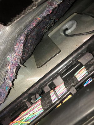

Got it back to the dealer today. The tech was confused since he had already done the 'technical bulletin' work and he said the sunroof only drains down the A-Pilar and the rear of the vehicle. I requested to stay so I could see what they find. They weren't sure when the work would start but send me pictures later in the day. I'm told, "We have found the source of the leak and will have it ready tomorrow". I can't wait to hear. From the pictures, it looks clean... moist, but clean.

From the dealer, "There was an elbow shaped hose for AC drainage that was causing the leak". Funny, that sounds just like the technical bulletin the salesman found and they supposedly fixed the first time I brought it in! I'm eager to clarify what the heck happened the first time, when I go pick it up.

Good news, sort of. The dealer called back to let me know it was taking longer than expected to dry out the pad. They pulled it completely out and found mildew. Ford will be replacing it, it's just going to take 5-7 days. I really hope this gets resolved...

Good news, got our Expy back. They had found mildew on the pad so Ford Replaced the pad and carpet. The dealer redeemed themselves by detailing the vehicle AND filling the gas tank, since they had it for a week!. Crossing my fingers it stays dry.

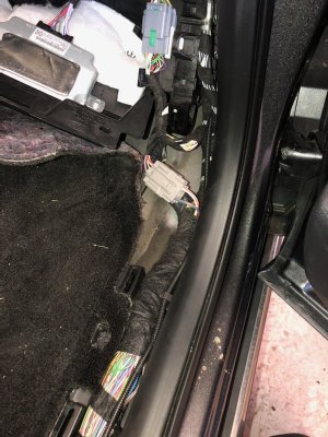

Dealer called Friday and the report is interesting... Ford instructed them to replace some kind of Evaporation module related to the AC? They had to pull the dash to get to it. Once the dash wash out, they found some issue with body seams and grommets?? The service manager apologized for not having more details but she felt this was the source of the issue and I'll get it back next week. I'm not convinced, but I'll update when I know more.
