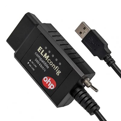

Forscan is downloadable software. You need to register it so you can make changes. Only works with real PCs, not apples. I'm guessing you have a ODB2 interface in your Amazon cart. I strongly prefer a physical cable connection to that port rather than Blutooth or whatever.

And yeah dont pay for forscan, it's a fee app! You just have to join the forum and then get the extended license key. Also Chucks said pc only not apples? What he probably meant to say is you need a windows operating system. I use my mac book pro running windows 10 on a separate partition. Here's a link to the forscan forum with the info on extended license key.
https://forscan.org/forum/viewtopic.php?f=5&t=836
And this is a link to the obd2 adapter I purchased.
https://www.amazon.com/VINT-TT55502-ELM327-modified-ELMconfig-FOCCCUS/dp/B01N18TOFB

I'm guessing you have a ODB2 interface in your Amazon cart. I strongly prefer a physical cable connection to that port rather than Blutooth or whatever.-- Chuck
My mistake, Chuck. Thanks. I have an ODB2 interface (actually being watched in ebay, not carted in Amazon).
https://ebay.to/2BFiwI3

Wow that's a pricy one, and from China? Time you receive it spring will be around the corner, lol.
I guess I clicked "watch" so that I could read more about it. Good point. I usually do some more research before purchasing. Hence this thread. :)
Also, I'd like to do this before Christmas for my wife. This Christmas. So, good call on the China thing.
By the way, a lot of the auctions say "modified for Ford". The word "modified" does not sound good to me.
If you have a suggested brand/model, I'd love to know. Thanks.
