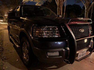

4BA38014-932A-4250-BDEE-22A3D37FD5DA.jpeg 4B8C1849-589D-4B3E-A258-EE626156EB06.jpeg While I was replacing that, I also replaced the master cylinder, condenser, drier, expansion valves, all new o-rings on AC, struts again(squeaky and the ones I bought were cheap crap before), hubs, wheel speed sensors, positive terminal, battery, idle air control valve, fuel filter, and fuel pump. I also added a grille guard, which I really like. Hope my update can help someone in the future.
