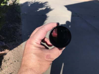

@302Xplorer , by way of comparison... I installed mine in March (2020).
I prefer the relocation that your (assumed) newer version has. I've put on about 1K miles
(since quarantine has me working from home) and shown below is the amount of oil collected in the reservoir.
We live in Colorado Springs, which is decidedly a dry and arid climate.

**Update**
After 5,000 miles of hard driving in temperatures usually between 75-85; here is what has accumulated in the catch can:
It looks like it would fill about half of a standard shot glass that some of us would use for imbibing bourbon.
