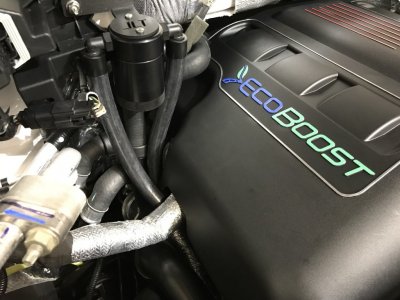

I installed the JLT oil separator last night on my 17 Expy. I have one on my 2013 Mustang GT and was amazed at how much oil is collected between oil changes.
Knowing the 3.5 Ecoboost uses direct injection, the injector never washes off the intake valves with atomized gasoline so carbon buildup is inevitable.
I had to play around with the hoses so the engine cover would properly fit but it worked out well. Here are some pics of the install. As you can see the JLT rubber hoses need to run underneath the wiring harness that has the aluminum heat wrap on it.
The part number is 3016P and it is the same one used for the 2017 F150's.

Very nice, thanks for sharing. Love how you painted the lettering on the engine cover too Very cool. Which ink pens from Amazon did you use?

Here is the link for the paint pens I used on my intake cover. https://www.amazon.com/gp/product/B000WXBEP0/ref=oh_aui_detailpage_o08_s00?ie=UTF8&psc=1
