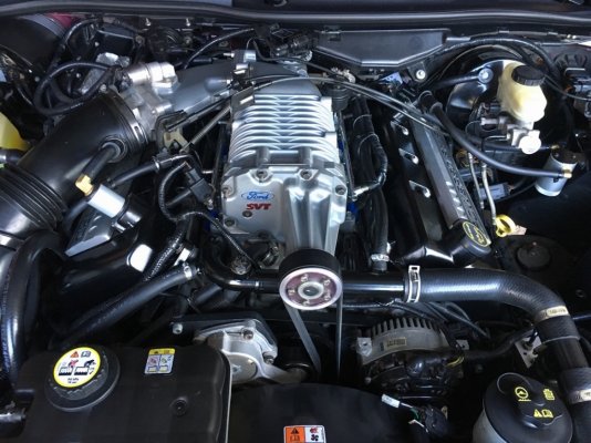

Be it hocus-pocus or something that is needed. I ordered new hoses from JLT as I already have a JLT can from my Marauder. It worked on the Merc and the can kept oil vapors off of the intercooler below the supercharger. I also had a prefilter on the intake side. But obviously two different beasts of motors.
So It can’t hurt my Expy and at least give a little peace of mind.
Pics of my Marauder JLT (car was totaled by a drunk. So I’ll use my catch can for my Expy.)
I always liked those Big Marauders.... I raced one with a blower at 75/80 Dragway with my 69 Eliminator. He drug my ass by 2 tenths of a second. We both had similar gear ratios, he had 3.55 and I had 3.50’s at the time. I got out on him but that blower ran down my naturally aspirated 390 right at the traps.

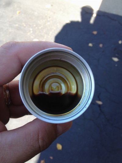

All this JLT and science talk sent me out to the '17 Expedition to drain the catch can. Last time it was completely full and I've no clue what oil it sent back to the engine. This time it had about about 20ml, less than an ounce.
I stumbled across the spreadsheet I'd created a few months back and the engine has 6302 miles on it since it was catch-canned (to make that a verb), has run 492 hours (including 94 at idle), and deposited at least 270ml of stuff into the can, a bit over 9 ounces. That's about 3 ounces (the can's tiny capacity) every 2000 miles or 140 days for me since I don't drive this exclusively.
I'm toying with adding the extension to the can to up the capacity to 6 ounces. This should allow me to just have to drain it twice rather than 4x a year. Yeah, it's 10 minutes with a 10mm socket and step stool -- I can't even reach the oil dipstick over the fenders of my '17. The '07 was no problem.
