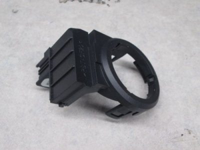

Can you tell me where the pickup is located? I have never seen it, just curious what it looks liker and where it is found? Dont want to break it by accident!!

It clips directly to the steering column and is a loop that encircles the lock cylinder. it would look something like this
111903317537
wires plug into the back of it and then when the key is turned the wire coil in the loop energizes and reads the data off the chip in the key and passes it along to the PATS system to authenticate and then allow the car to start. I wish I had taken a couple photos of mine but its pretty obvious where/what it is once you pull the plastic shrouding off the steering column
