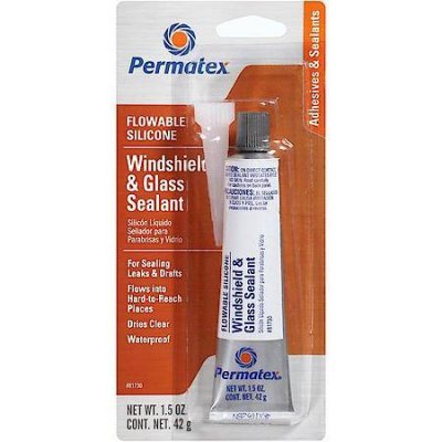

Hamfisted
Nov 20, 2012
2,893
1,795
Ft Lauderdale
