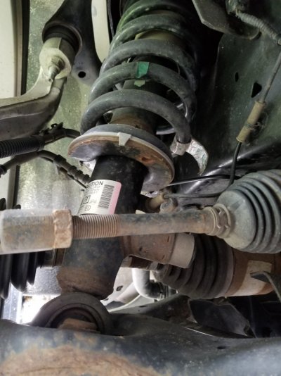

I noticed a small mount of oil on the front right axle - right near the end. I estimate it to be only about 1 Tbsp, based on how little was on the undercarriage tray. Rig has 44k miles.
Anyone else see some leaking here? I found one other person posting about it, but it was nearly new rig.

Picture would be helpful. I would think its more likely the shock is leaking than the axle. Not sure where exactly you are seeing this though.

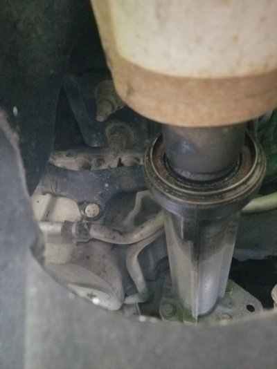

Sorry, I wiped off the oil from the axle, but you can tell where it's been wet. I would say there is nearly zero chance it's not the end of the axle seal. Picture of the dry shock as well.

Does look a little wet but not really bad. You could have the dealer look at it just to document but it doesn't look too bad to me. I'm new to this Independent suspension stuff, not certain what is a lot or a little with them. I know the front axle on me jeeps leaks a little when I park off camber or over fill the diff.

I just checked and its still a little wet with oil. Also noticed some oil staining on the felt panel. Scheduled and appt with the dealer so it can get checked before ski season starts and we hit the mtns.

Dealer confirmed leaking front passenger axle seal. Warranty replacement in progress. 2018 w/ 49k miles
