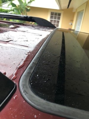

So on my 10' Expy I have water all over the passenger seat, floor, and headliner. Going through web for cause I've found one of the drains was plugged up. I did my best with can air and weed-eater line and it seems to have cleared it up enough to drain the water when I did a test. The passenger front drain seems odd to me that I can only snake weed-eater line about 8" before I can go no further, but can go much further on the driver side. I partially took apart the headline and pillar covering and cannot find the drain tube much less the drain tube to plug, but whatever, seems to be working now.
But what really concerns me is water tests and seeing how much water is coming in the seams of the sunroof. Poured from a water bottle it's like a faucet, put out in rain is a bit better but it comes in all around the circumference of the sunroof glass. I tried adjusting the 4 torx screws and pushed up the glass a smidgen to see if it would help but it did marginally at best.
So what is an acceptable amount of water to come in? I was assuming maybe some slight dripping, but this is way more than that. And looking at replacement gaskets one, how much better can I expect improvement over the 10 year old present one? Has anyone replaced their gasket on the sunroof? Is it a simple procedure?

the seals are designed to channel water, they are not water stoppers, the tubes are there to channel the water out and down to the ground.
my 2013 f150 and the 2010 both had blockages on the drains,
try LOW pressure air less than 10 psi to blow the tubes free of crap. both mine stopped up at the bottom where they exit the vehicle.
fishing line (weed eater is a good start) to snake them. after the lines were cleared we never had any more issues. never had any issue with the 16 expy as of yet.

Yeah, I got the drains unclogged, but the amount of water that comes in is unacceptable.
Is the gasket replacement straight forward? Has anyone done it before? Require glue?

You may need to consider disconnecting power and caulking it in. I’ve replaced my seal and it was relatively easy with some lube. But my seal was cracked all over and it still wasn’t leaking like yours is. The drains are designed to accommodate a slow drip leak, but like others have said if your sunroof glass is installed correctly it should not leak at all. I’m guessing you might have a deformity in the roof.

What a mess this has turned out to be. I eventually ordered a new gasket. Got that today and after installed it quite easily onto the glass using some soapy water. Then the fun began. Put it back in place and then went to start screwing in the screws and adjusting the height on the 4 corners. That wasn't very easy, getting all 4 corners to get right where I thought they should be was a struggle. Eventually it got close enough. Did a water test, a small bit of water came in and I figured I could maybe do some more adjustments to get it better.
I then decided to open the sunroof to see how it would re-seal when closing. Well, POP goes some small plastic parts and now the sunroof will not close. Track assembly broke. Took a better park of 45 min of attempting closings and removing bits of plastic to get it closed and I'll still need to prop something under one corner because it's now loose.
Initial homework online indicated this could be very costly to fix and sure enough I just returned from the local Ford dealer and was quoted $2500. Unbelievable.
Has anyone had any luck replacing the track assemblies themselves? I see kits online for $30, but I know the labor is the kicker.

Sunroof dr sells the tracked parts that break and a youtube video showing all the steps. Plan on a Sunrise to Sunset project by yourself. Some people report their local non-dealer shop installed the replacment tracked parts for a Quarter of the FoMoCo dealer cost.
$30?! What kit is that? $2500 for labor and Ford installs a whole new sunroof assembly is why $2500.
