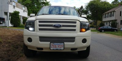

I like my acme switchback Leds. White for marker/ Amber for blinker
Drivers blinker is on in the pic.
I used forscan to disable hyperflash for the rears but needed load resistors for the front.

Resistors on DRL/blinker switchbacks are a pretty bad idea... lots of meltable and burnable plastic in the area
Well resisters need to be mounted to something metallic. If not they can't disperse heat the way they were designed. Mounting them to a surface that will not transfer heat is how load resistors melt!
Also why would it matter if its a switchback? There's no more plastic than a traditional led bkinker
