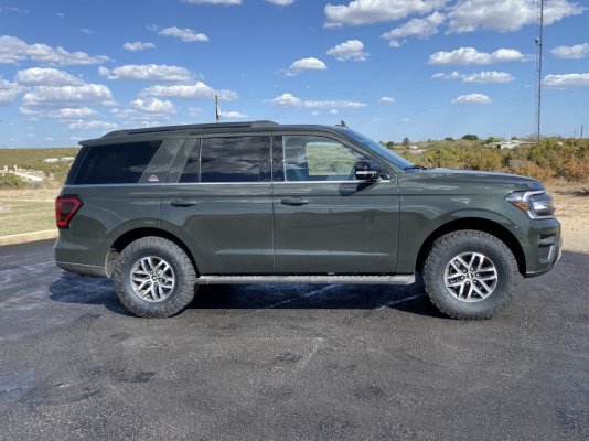

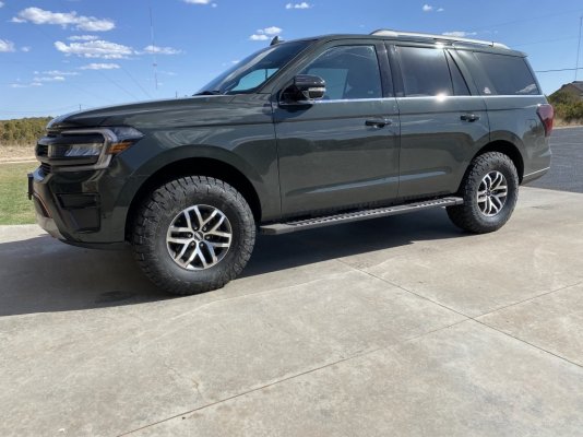

Stock height Timberline with 305/70R-17 AT3’s on 2017 Raptor wheels.
Seems to clear everywhere so far although haven‘t tried hitting any bumps with the steering wheel cocked.View attachment 74044View attachment 74043
What is the offset of those rims? Is there any poke? I am looking at 315/70/17 on a 25mm offset.
The concept has 35/12.5/17 albeit a 2" lift wonder if those fit on the timberline with no lift.
M390
Jun 6, 2022
Believe 2017 stock Raptor wheels were 34mm offset. Just the tiniest bit of poke on my Timberline.

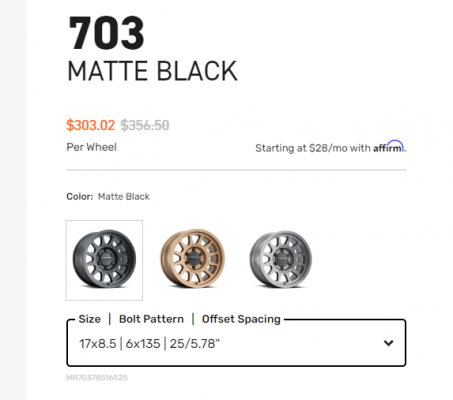

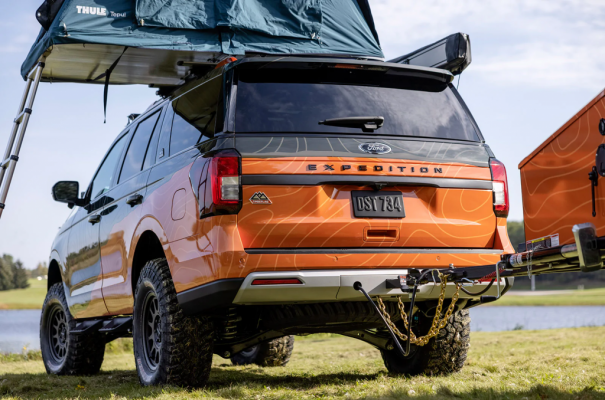

The SEMA build uses Method 703s. They have a +15mm offset. Tires are General Grabber 35x12.5 R17s. Suspension is CUSTOM and based on the Fox Performance Elite 2.5 shocks. Penske did the build and are keeping it all pretty secret. No one has released any mods for it yet. Since the rear wheel has been kept centered, I think they also have a customer lower arm. Can't find any documentation to prove this or not.
LazSlate
May 7, 2022
416
245
Arizona
The only options for 703s I see are 0 and 25mm so I would imagine the Sema used the 25mm offsets.
